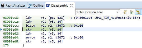

When the attached ioc file (minimal test case, consistently reproducible) is generated using CubeMX 4.24, firmware package V1.6.0 and built with TrueStudio 9.0.0 the processor locks up when it reaches the call to
__HAL_AFIO_REMAP_TIM3_ENABLE()
inHAL_TIM_MspPostInit
for TIM3. The processor is an STM32F103RF. No additional code was added and no code modified from the original generated code.else if(htim->Instance==TIM3)
{ /* USER CODE BEGIN TIM3_MspPostInit 0 *//* USER CODE END TIM3_MspPostInit 0 */ /**TIM3 GPIO Configuration PC6 ------> TIM3_CH1 */ GPIO_InitStruct.Pin = GPIO_PIN_6; GPIO_InitStruct.Mode = GPIO_MODE_AF_PP; GPIO_InitStruct.Speed = GPIO_SPEED_FREQ_LOW; HAL_GPIO_Init(GPIOC, &GPIO_InitStruct);__HAL_AFIO_REMAP_TIM3_ENABLE(); // <<===== LOCKUP!
/* USER CODE BEGIN TIM3_MspPostInit 1 *//* USER CODE END TIM3_MspPostInit 1 */ }The processor seems to lock up and the STLink debugger loses its connection when the red line above is executed. In the debug console, the following output is observed:
Debugger connected
Error in executing 'step' command ... FAILED to REGISTER Values from the targetTarget is not responding, retrying...Target is not responding, retrying...Target is not responding, retrying...Strangely enough, two error messages appear in red, but then disappear. After much trial and error, I managed to capture the errors in the console:

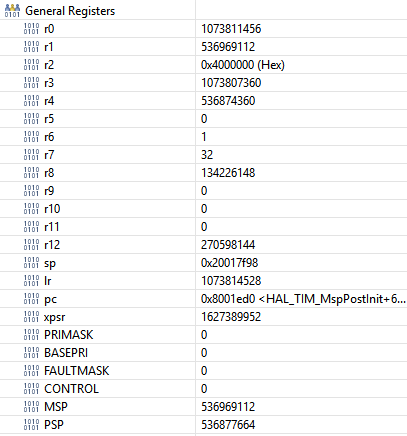

I stepped up until the line it crashes and copied the asm and register state, as below in the screenshots:This appears to be when the code is writing the flags back to the register with the following line (expanded from the macro):
CLEAR_BIT(AFIO->MAPR, AFIO_MAPR_TIM3_REMAP);
‎2018-03-14 1:43 AM
Dunno why Eclipse (TrueStudio) has integer format view for registers as default ... R3 equals to 0x40010000 at that time.
I don't know the memory map of your device by heart, so can you check if this address is valid, and makes sense in this context ?
Register addresses are listed in the Reference Manual.
If the address is valid, the clock of the peripheral you trying to access might not be enabled. Cube is said to contain some bugs.
Does TrueStudio's 'Fault Analyzer View', as seen in you screenshot, has anything useful to say ?
