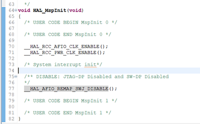

I did generated simple project for STM32F103VEx.  Project if fairly simple just uses USB in CDC mode.
I did generate similar project for same processor but only SPI3 using shared pins PB3 and PB4 with JTAG.
Each time while I did generated those projects CubeMX forces to distable whole debug communication JTAG +SWD
by adding line
    /**DISABLE: JTAG-DP Disabled and SW-DP Disabled
  __HAL_AFIO_REMAP_SWJ_DISABLE();
While SWD could be turned on since it does not conflicts with any of those peripherals. STM32 have options to disable only JTAG or either distable only NRJST pin in JTAG. Why CubeMX forces to kill all of the debug communication ?
Simple project attached. Example file located in testCDC/stm32f1xx_hal_msp.c function void HAL_MspInit(void)

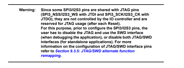

Yo can refer to the RM0008 reference manual in the section ''JTAG/SWD alternate function remapping'' to have more details and clarification about your case, as mentioned prior to configure SPI3 that user has to disable the JTAG and use SWD interface or disable both JTAG/SWD.

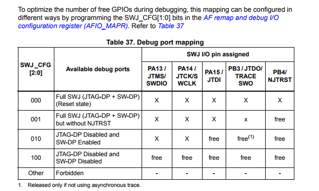

I know about
RM0008 and JTAG/SWD remapping table. I am just concerns that clean project generated from CubeMX
does not switch off only JTAG but whole debug communication and does it in the non obvious part of code. I manage to make it work, but imagine people which try to do it first time and their evaluation board do not respond after first program.
I think this is a bug in CubeMX and it should switch off only those debug ports which is needed. In that case just JTAG while it turns off all of debug communication.

Re-enable them in a user code section so it isn't removed after regeneration.
