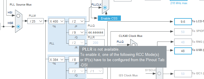

Assert Failed: FILE - ../Drivers/STM32F7xx_HAL_Driver/Src/stm32f7xx_hal_rcc.c, LINE - 602
RCC_OscInitStruct.PLL.PLLR is not assigned a value, therefore = 0, which fails above assert
Adding following code resolves issue
/* CUBEMX BUG FIX
* PLLR not initialized to a valid value
* PLLR >=2 && <= 7
* Initialize to 2 (reset value)
RCC_OscInitStruct.PLL.PLLR = 2;

Hello @svcguy​
You have to check if it's being used by a device. If not, it should be grayed out.
Best regards,
Nesrine
‎2020-02-03 6:34 AM
Correct, it should be greyed out on this device as it doesn’t have DSI, but the clock config code that it generates still fails an assert without a way for the user to change it every time the code is regenerated.
