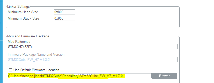

Hi
Although I configure in the cube that no external transceiver is used the define is set in the file (stm32h7xx_hal_conf.h).
Any idea?
Regards Jakob

Hi @jakob.brunhart​
You are using an older version of the firmware.
Try this version of Firmware Package "STM32Cube_FW_H7_V1.7.0", it works correctly.
Best regards,
Nesrine
