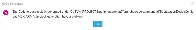

Anybody else run into this error with STM32CubeMX? Any suggestions on how to fix it?
‎2020-08-25 11:26 AM
I amusing STM32CubeMX version 6.0.1.
My board is based on the STM32L071RBT6 MCU.
I am using the IOC file attached to this post.
The code generator is configured for KEIL MDK 5.27 (same with MDK v5).
The code generator appears to complete successfully -- I get a pop up indicating the same.
However, when I click on either of the two options (Open Folder, Close) I get the same error popup shown below. I also notice that there is no startup or scatter load descriptor either

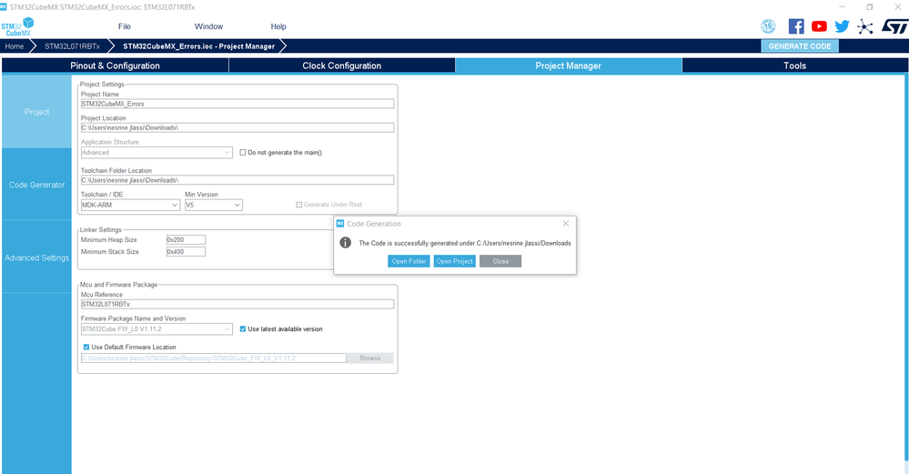

‎2020-09-02 7:35 AM
Hello @RMand​
Thanks for the feedback, i did the same scenario and i had no issue.
Please try to uninstall then install keil MDK again. It should works correctly.
Best regards,
Nesrine

I went ahead and uninstalled, and then reinstalled, the latest MDK that is available with support for the STM32F0/L0 MCU families.
But still see the same behavior.
What I do not understand is why the message in the pop up keeps referring to MDK v5.27 (I used to have MDK v5.31 and after the reinstall it is at 5.35)
Cheers
Ramanand
‎2020-09-11 2:19 PM
I would like to raise a ticket to resolve this issue.
I do not understand why the CubeMx is looking for MDK v5.27 when I do not even have that tool installed on my PC and I never set up the Cube to refer to this version of the KEIL toolkit.
