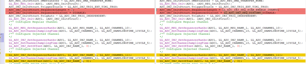

2021-11-22 8:18 AM
There are several other Bugs.
Code as it is generated (left) compared to as it should be (right):

2021-11-22 8:39 AM
2021-11-25 12:11 AM
Hi @FMink.1 ,
The original issue has been fixed (issue raised in the description), this one is newer, and thank you for raising it to our attention, I already analyzed the problem and I confirm the issue, but could you please add new post, so that the issue will be visible to the other Community members which are facing the same problem as you and to be able to put a status on it?
