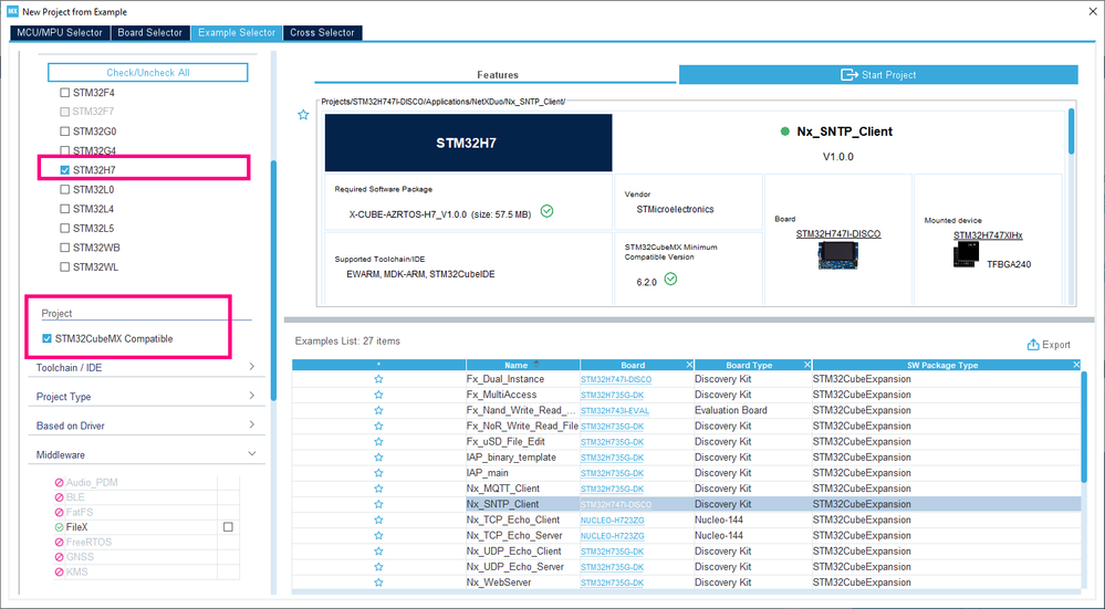

Hi @Community member​ ,
To have the full list of H7 example with ioc you can refer to Example Browser in CubeMX using the filter "STM32CubeMX Compatible" .
The result table contain all examples with ioc.
Hope this helps you.
Houda

Houda GHABRI
Houda
