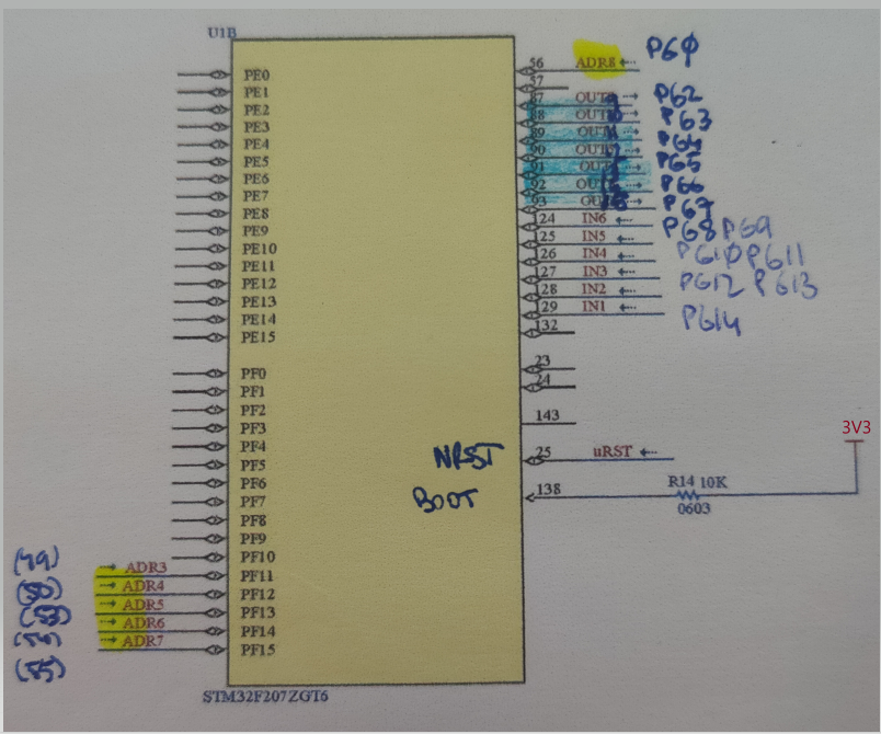

Pay particular attention to BOOT0 being pulled LOW, the VCAP capacitors/voltages, the analogue supplies.
Watch the clocking source, perhaps use HSI+PLL as HSE on NUCLEO provided by a constant 8 MHz clock.
Share portion of schematic.

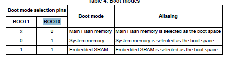

Since this mcu datasheet says:
0693W00000Y8QRjQAN.pngI noticed that Nucleo board has the first configuration values by default (it is possible to see looking at the Nucleo board schematics). So when it is programmed with ST-Link GDB series, binary file is downloaded and writen on the main flash memory - before PC counter starts to increment its count -.
The custom board is an heritance from external designer. I took a look to the scheme and I could see that BOOT0 is being pulled up to 3.3V.
Obviously the start system seems not to be the same. But the fact that I don't know if this configuration was thought (even needed) to program the memory of the mcu using SEGGER J-Link.
Could it be reasonable that BOOT0 must to be tied to high?
I think not, because this board is using BOOT1 pin (B2) as a digital input, but... who knows.
I will make some fixtures on the board in order to get GND on BOOT pin instead VCC and I will try to debug once again.
