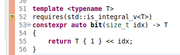

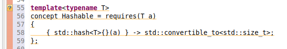

I'm writing C++ code wih STM32CubeIDE. Version of IDE is 1.11.0 and it comes with arm-none-eabi-g++ version 10.3-2021.10 . The compiler has some of C++20 features and I'm using them in the code.
The problem is some of them are not recognized by the IDE although the code compiles and runs flawlessly.
I can give3 examples that STM32CubeIDE has problem with them.
  1. Spaceship operator
  2. Concepts
  3. Constraints

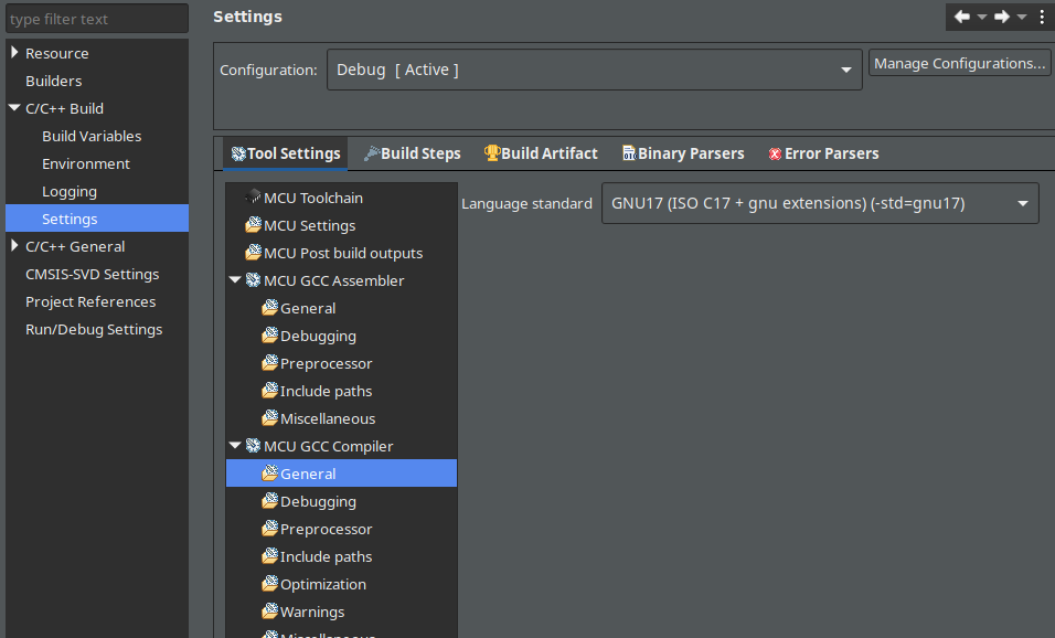

AScha.3
did you set it in project options ?
(here set C17 )
Yes I did. It's set on C++20. As I stated, the whole project compiles and runs.
Wijeden RHIMI
Hello@ navidcity,
Please put those two information into your consideration :
  • The compiler accepts all C ++20.Syntax.
  • the Issue is related to CDT environment : it is not supporting C + + 20.syntax .
Don't hesitate to ask any more questions.
Wijeden,
Then it's a known issue to you.
I think I have to wait for next versions of IDE.
