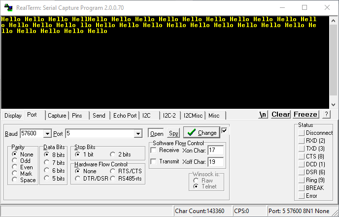

When I use Realterm, I have the following data received by the PC:

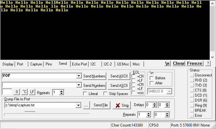

When I send data to the MCU with RealTerm (e.g. the string "YOP") :

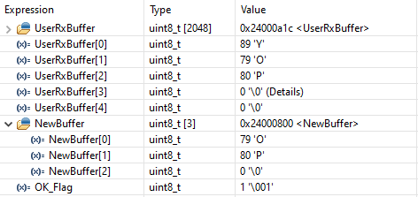

Using the debugger, I suspend the process and watch the data, which have been received:

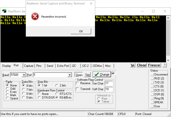

However, as soon as I enable the I2C, I can't communicate with RealTerm anymore (I also tried Putty with the same results).
