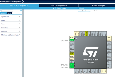

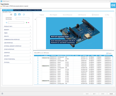

If I use CubeIDE 1.19.0 there was a target board selector after starting a new project. In 2.0.0 I can not find it. Slso the GPIO config.
What happens?

Hello @blafusel
In the latest release , STM32CubeMX is no more integrated in STM32CubeIDE 2.0.0
For more details , please check this STM32CubeIDE 2.0.0 released
 To download CubeMX standalone please use this LINK

As @Ghofrane GSOURI already said, this is no longer integrated in the IDE - you need to use the standalone CubeMX tool.
See: STM32CubeIDE 2.0.0 New workflow tutorial
For explanation & discussion, see: IDE Version 2.0.0 - why remove MX ?
@blafusel  in couple of words, you need to create your project and generate the code in CubeMx (stand alone version) and built it in CubeIDE.
