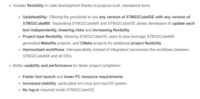

There are two main reasons: flexibility and performance:
Dec 8, 2025 16:19 UTC
These are all reasons against any IDE.
I am in fact not a fan of an IDE. Nearly all work suits better for me with standalone tools like EMACS, the toolchain and gdb.
The only exception where I was persuaded to an IDE was STM32Cube. And this was exactly because of the integration with CubeMX. (Even here I used EMACS to edit longer passages of source code, but at least I used an IDE.)
When CubeMX is not integrated anymore I see no real reason to use the enbeloved Eclipse. And return to flexibility and performance...

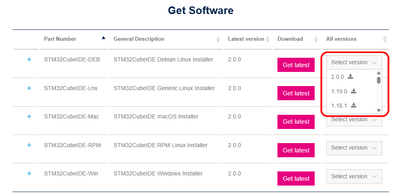

I've felt compelled to revert to version 1.19.0 ( go to Help -> About STM32CubeIDE -> Installation Details -> Installation History -> select version -> Revert)
You can download previous versions from the website:
You can install & use multiple versions at once.
