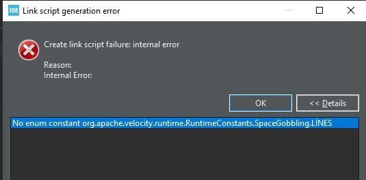

When first building, I get this error, How can I solve?

strange error, shouldn't happen. Check that your workspace in on an "easy" path, i.e. no spaces, umlauts difficult or non-ASCII charcters in the folder path. If this doesn't help, reinstall IDE from scratch.
hth
