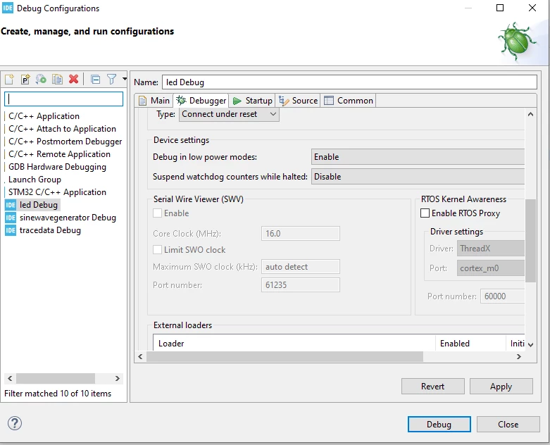

How do I enable SWV in my STM32Cube ide?
I am trying to use SWV viewer but in Debugger option, there is no SWV options available. Is it because of some faulty pin configuration? Because i ran a blink led program and it's working fine. Just the SWV, i cannot enable. 0693W00000Y7ZK6QAN.png

Jan 6, 2023 10:49 AM UTC
Hello @RShre.2​ and welcome to the Community :)
SWV options is not available and not work with Cortex-M0.
Imen
RShre.2
RShre.2Author
Jan 6, 2023 10:58 AM UTC
Thank you for the reply. Do you know if there is any other alternatives to view plots in computer without having to use an oscilloscope?
Wijeden RHIMI
Wijeden RHIMIBest answer
Jan 9, 2023 10:24 AM UTC
Hi @RShre.2,
Could you please choose one of those two options :
  1. Use live expression as an another alternative
  2. If you have a Segger probe you could use the API and the debugger offered by Segger :
please check those two links :
J-Link RTT – Real Time Transfer (segger.com)
Ozone – The Performance Analyzer (segger.com)
Best regards,
Wijeden,
