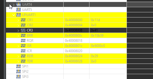

During debugging in my code, I enter in the function HardFault_handler (), I know then this error is about the registers but I don't know how interpreter this registers.

The PROCESSOR registers, not the PERIPHERAL ones. ie R0, R1, R2, LR, PC, etc and the values pushed to the stack. Perhaps one of Joseph Yiu's books on the Cortex-Mx part would be easier than the ARM Technical Reference Manuals.
