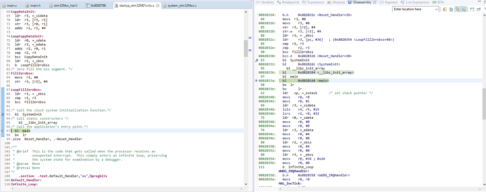

I tryed to run the called firmware from debugger and after the return 0 in line 9 it returns in the reset handler, in particular in the third line:
/* Call the application's entry point.*/
bl main
bx lr
I think that is normal if i launch the second firmware without the first one, it returns in the reset handler, but looking at the disassebly flash address with the debugger, it is the same address that goes into when i call the second firmware from the first one.
I think it is a bit strange because if i call a function, when it returns, it should have the return address and so it should return in the address that called it. Do you know what am i doing wrong?

Maybe I am missing something here.
Why do you call the second main() via the the Reset_Handler in the second program? Could not you just call second main directly?
As it is now it seems main() will return to Reset_Handler function in second program...
2020-08-20 05:10 AM
Thank you for the answer!
You are right, i noticed that if i set the function address via the second program start address (0x8020000) i go in the reset handler of the second firmware.
I tryed, debugging the second firmware, to detect the address of the main:
So i set the address of the function (removing the "+ 4") to 0x080201D4, but when I call it from the first firmware i retreive an hard fault. I tryed the addresses from 0x080201C9 to 0x080201D9, but same result. What could be the problem?
2020-08-20 05:54 AM
Did you tried to set the address to 0x080201D5 instead.
