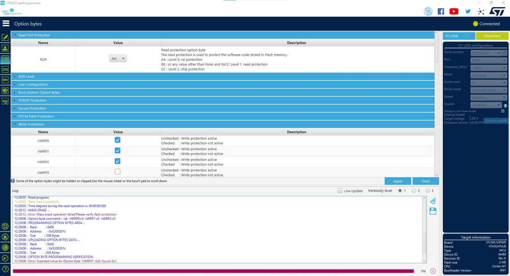

Thanks for working on this.  I'll be interested to see what you find out.  In the mean time, here are a few more hints.
I still can't just clear all the flash. Here's a screen shot of what happens. I've tried checking and unchecking the nWRPx boxes and CubeProgrammer just sets them back to their default setting: nWRP0, 1 and 2 are checked. nWRP3-34 are unchecked and nWRP35-63 are checked. .
At one point after fumbling around reinstalling software and trying to clear at least some of the flash with CubeProgrammer, I was able to build a new Blinky program, load it with CubeProgrammer and it ran. I wish I could tell you what I did to get this little bit to work but it was kind a random process.  Unfortunately, when I try to load the program that I've been working on, I get the errors at the bottom of these messages.  This program is much larger than the Blinky program I mentioned above, it's something like 360 kBytes if that matters.

Info : Erasing FLASH: 0x08000000-0x0805c000...
Error: wait_flash_op_queue, WRPERR detected
Error: erase time-out or operation error sector 12
Error: failed erasing sectors 0 to 45
Error: flash_erase returned -4
Info : accepting 'telnet' connection on tcp/54040
FWIW, it does seem possible that my current issue has to do with not being able to write to certain parts of memory.  The Blinky program that does run is 4.8 kB, the larger program that doesn't run is 360 kB and another program I tried that doesn't run is 216 kB.

I was finally able to clear all the flash on my MCU.  I had to connect BOOT0 to ground (not 3.3VDC).  This seems incorrect but it did work.  I've started and stopped the program, the IDE, the STLink-V3PWR several times and shut everything down and rebooted the computer a couple of times and I can still download, run and debug my main program.  So that's good.  Hopefully, it will last for a little longer this time.
Thanks again for all the help and if you can figure out why connecting BOOT0 to gnd allowed me to clear the flash, I'd be interested to know.
It would also be nice to know what the nWRPx check boxes are doing since I can't find a mention of them in the reference manual.

Hello @magene
Great news to know that you are able to connect your board and erase its flash.
- For boot there are 2 parameters, boot0 pin (controlled by boot switch) + BOOT_ADD0 (by default user flash 0x800_0000) and BOOT_ADD1 (by default system flash 0x1FF0_0000).
-  Connecting BOOT0 to gnd is the same thing as putting the boot switch into userflash position. If not working with putting the boot switch, may be the the switch is damaged!! ,
- Choosing the system flash as boot (boot switch or Boot pin to VDD), means you are executing the embedded bootloader. No need in your use case as the bootloader is used to reprogram the flash memory using one of the serial interfaces (usart, i2c ....)
- By default all the nWRPx must be checked, means that there is no sector in the flash that is write protected. Do you changes these nWRPx option bytes ? If not, does you application have some code changing the nWRPx flash option bytes ?  if none among above did, means that there is an issue in the hardware !!!
- One more possibility to answer, why nWRPx is set, bootloader in the system flash is setting WRPx  but I double checked it is not the case !!!
