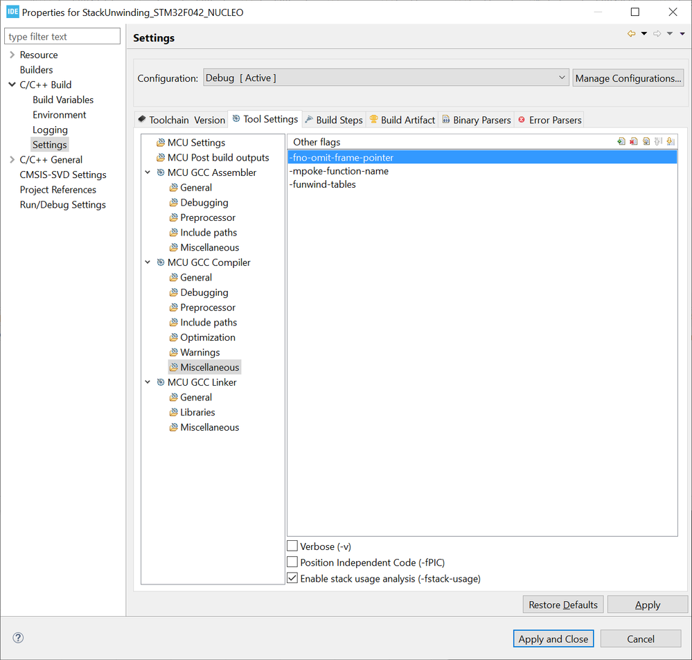

‎2020-10-07 1:32 AM
Yeah. In general automated stack unwinding in thumb2 mode without using debug info seems impossible, even when r7 as frame pointer is enforced (-fno-omit-frame-pointer):
Here is an interesting approach using debug info: https://github.com/red-rocket-computing/backtrace

Could you please tell me how to enable the compiler option you mentioned? I didn't do that
‎2020-10-07 1:53 AM
Ohh, I only ment that there is some dereferencing needed within the loop, sorry.
Copy backtrace.c and backtrace.h files from https://github.com/red-rocket-computing/backtrace to your project and start with their ping-pong like sample.
In STM32CubeIDE: Project > Properties > C/C++ build > Setings > Tool settings
these need to be enabled:
