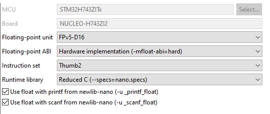

I want to use the intrinsic floating point absolute value function `__fabs` as noted in the compiler specific features in the armcc documentation.
When I build my project using the following settings on STM32CubeIDE:
I get an error saying undefined reference to `__fabs`; when I switch Toolchains to MDK-ARM the project compiles fine with `__fabs`. Are there some settings to enable intrinsic on STM32CubeIDE?
Thanks
But the compiler of CubeIDE is not armcc. It is gcc.

This may not be the solution you were looking for; however, I was left with some constraints;
  1. I did not want to include the entire math header.
  2. This had to compile for STM32CubeIDE, MDK-ARM, and a linux version.
My goal for the following code snippet was to use the standard math libraries `fabs` function if the intrinsic function was not defined.
// declare math fabs
double fabs(double);
// declare instrinsic __fabs for armcc
double __fabs(double value) __attribute__((weak));
double __fabs(double value) {
 // use math libraries if not found
 return fabs(value);
static inline double floatAbs(double value) {
 return __fabs(value);
