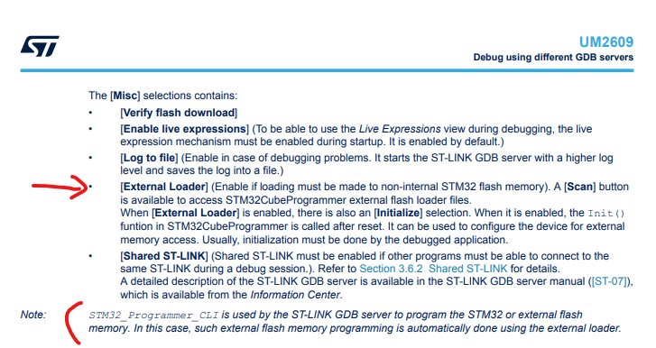

EDIT: I just discovered it works in STM32CubeIDE. With external memory initialize set to disable it will flash it anyway. But it will crash when I enable it. I don't understand the logic of it, but it works! Somehow there are occasional read errors with the flash chip so I reduced the clock speed from 70MHz to 56MHz

2023-01-20 9:35 AM
Yes. That's what I did. I added the flash loader to the launch file. I have Enable and Init checked.
2023-01-20 9:39 AM
Hmm. That's odd. STM32CubeIDE can flash the internal FLASH without any issues and so can STM32CubeProgrammer if I don't select external FLASH. Nothing is locked or protected. We have several of our PCBs and they run without any issues, so power problems are unlikely.

LOAD 0x008850 0x240c8850 0x081d020e 0x00000 0x00600 RW 0x10000In my launch file I added the external flash loader and set initialize to disable. I can now flash the elf file with STM32CubeProgrammer and I can debug, but not flash the external flash, in STM32CubeIDE.
I get the following error in STM32CubeIDE:

Exit.So it kind of works, but, I wish there is a way to get it working properly.
