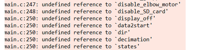

'undefined reference to..' error, after defining in main.h and creating a function.
Odd_coder
Am working on a code to control a robot and receive data from IMUs on the robot using NUCLEO-L4R5ZI-P. The generated code is proper but am having issues with the with my used code. below is what i have in main.c

here is the functions.h that defines the variables:

And here is main.h:

In my understanding, all the variables have been defined. but am still getting the errors on all the data defined in main.h below:
apologies for the long post, but I have tried a lot of fixes to try to clear and have the code build but no luck. Any help is appreciated on how to define these items.
The project was shared in private as the user requested.
The issue was solved:
Basically the issue:
All variables were declared in main.h. That file is included in more than location which induced to object multiple definitions.
Fix: all these variables declaration was moved from main.h to function.c file and exported in function.h as extern.

Guru
Start with the first error.
I don't see a definition for disable_gripper anywhere. It's declared (not defined) in main.c and in functions.h.
Is there a function.c that defines it? Is that getting compiled?
Similarly, for variables, I don't see a definition for u_tilde anywhere. What file is this defined in and is that file getting compiled?
SofLit
Where did you define all these "undefined" objects?
You exported them in function.h but you need somthing like a "function.c" file where these objects need to be defined and function.c to be added to your project.
Yes, I have a functions.c below that is being compiled.

The first error complains about disable_gripper on line 221, but line 221 is a comment. It could just be the formatting from the forum, but ...
And why are there so many global variables? It's a style thing, but globals have been considered harmful since 1973.
The definition for disable_gripper is not in the file you posted.
Ok but I don't see the undefined objects declared in function.c file.
for example "disable_gripper", "decimation" .. etc ..
They were not declared in your function.c!
Neither are any of these:
I didn't check the rest!
The fundamental problem does, indeed, seem to be that you have just declared these things, but not defined them.
https://c-faq.com/decl/decldef.html
https://community.st.com/t5/stm32cubeide-mcus/adding-new-c-source-files-to-my-project-and-navigating-through/m-p/657455/highlight/true#M25847
I did not show them in the main.c, they come after GPIO_Init as below:
* USER CODE BEGIN 4 */
static void disable_elbow_motor(void){
