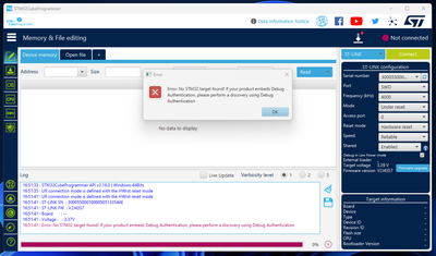

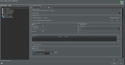

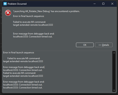

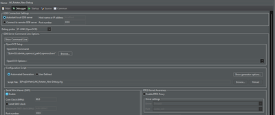

  I am trying to upload my code using ST Link(SWD)into a custom board with an STM32 Core. I am using serial wire debug for programming. So I am getting the above shown error messages. If anyone have come across this issue, please help me resolve it.
 I tried uploading the code using STM Cube Programmer also. I am getting the above error.!
