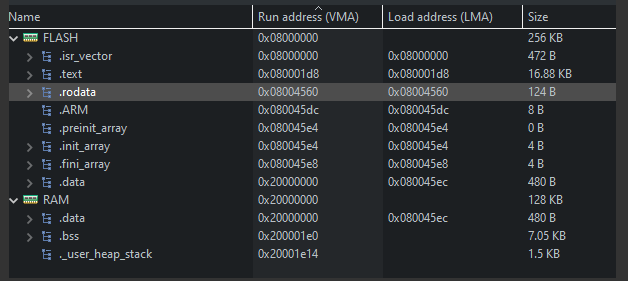

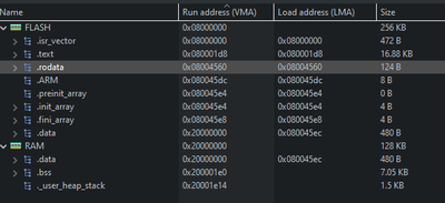

Hi everyone, I created an HID bootloader for the STM32G4xxx, it works and now I am trying to optimize the size. After compiling I can read this on the Build Analyzer a flash memory usage of 17.85 kB.Screenshot 2024-06-06 181018.png

    What's programmed into Flash is more than just the code - there's also all the data initialisation values.

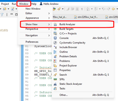

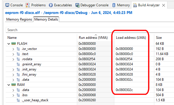

    The Build Analyser shows you exactly what's going into the Flash, and where:
    Everything in the 'Load address' column is stored in Flash
    .text is your executable code; some of the other things are mentioned here:
