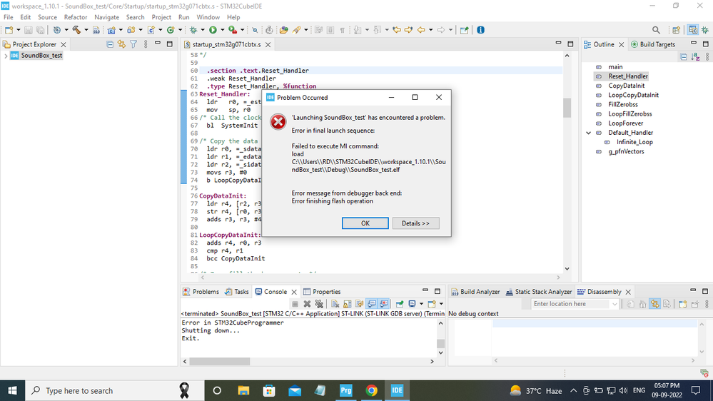

‎2022-09-09 4:44 AM
I have the same problem and in my directory, there is no cli.exe it has only file:///C:/ST/STM32CubeIDE_1.0.0/STM32CubeIDE/plugins/com.st.stm32cube.ide.mcu.externaltools.cubeprogrammer.win32_1.0.0.201904021506/tools/bin/STM32_Programmer_CLI
