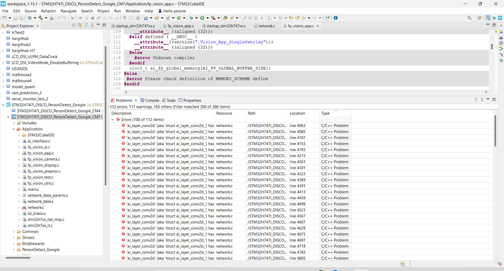

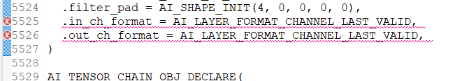

when i build the project the file network.c generated 110 errors and all errors are from it alone. the other files dont have a single error .and all the errors are likeScreenshot 2024-07-24 133417.pngexample of lines that have errors in network.c file(there is plenty like this in many other places in the filesexample of lines that have errors in network.c file(there is plenty like this in many other places in the files this type
Description Resource Path Location Type 'ai_layer_conv2d' {aka 'struct ai_layer_conv2d_'} has no member named 'in_ch_format' network.c /STM32H747I_DISCO_PersonDetect_Google_CM7/Application line 4063 C/C++ Problem
so is there any solution or guide you can help me with
