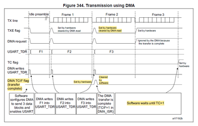

starkm42
this diagram states that TXE flag is acknowledged by DMA and cleared after every read, so is this not the case on M2M ?
sorry if i am missing the obvious, this is my first micro-controller, and still am getting hang of things.
also if i remember properly, M2M is just a way of triggering DMA request right ?
Thanks.
waclawek.jan
First that text should say "Cleared by DMA *write* (as TDR is *written* by DMA, not read) ( @Imen.D , can you please have a look at this? It's RM0316. Btw. the next figure, Fig.345 has an error, too, in labeling the first line, it should be Rx rather than Tx. Thanks.)
Second M2M DMA mode does not work out the peripheral triggers (the more correct expression, used also on that figure is "requests"); it simply shovels data from source to destination as quickly as possible.

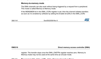

starkm42
yes, disabling M2M seems to get the intended results, thanks !
just curious, where is this information specified ?

waclawek.jan
It's kind of a "common knowledge" one is supposed to learn in college or so. Nonetheless, it's thankfully properly documented in the RM, too:
