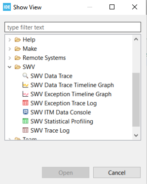

i dont have experience with it but yesterday i found out the stm32cube ide has a trace viewer for the SW debugger (the one built in in every nucleo board):
window->show view-> other ->swv
is this what you were looking for?
