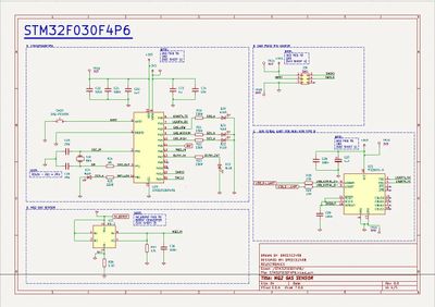

It seems that for whatever reason the ST-Link cannot reset properly, and I am unsure as to how to fix this.
Here is the schematic portion of the MCU:

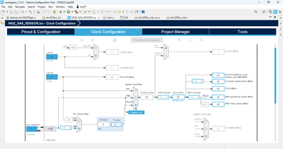

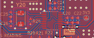

I found the solution,
the board uploads when I have the crystal set internal instead of the external setup I have but I'm not entirely sure why. I chose the ECS-80-12-30-JGN-TR with two 20pF caps at CL1 & CL2, and have Rext at 0 ohm acting as a jumper for now.
I'm not entirely sure what's causing the bootloader to essentially get stuck at the end of the cycle when uploading it, but I'm assuming its something to do with the way I set up the crystal.
Heres is the layout on the board:

AScha.3
1. on nrst /reset put a cer.cap , typ. 100nF , to gnd.

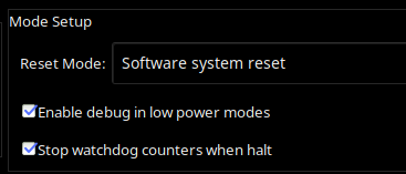

2. in IDE set debug -->
Try...
This is what I get as a result of that

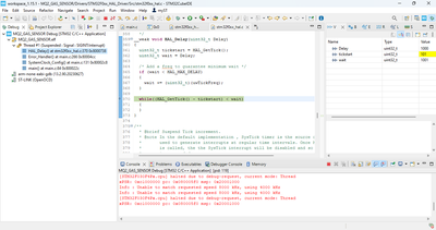

 and there's a line at HAL_Init();
I seem to get this output far more, I think it was just something with my debugger but the orange LED on the ST-LinkV2 is flashing and doesn't stop.
Heres is also a screenshot of the IDE:
