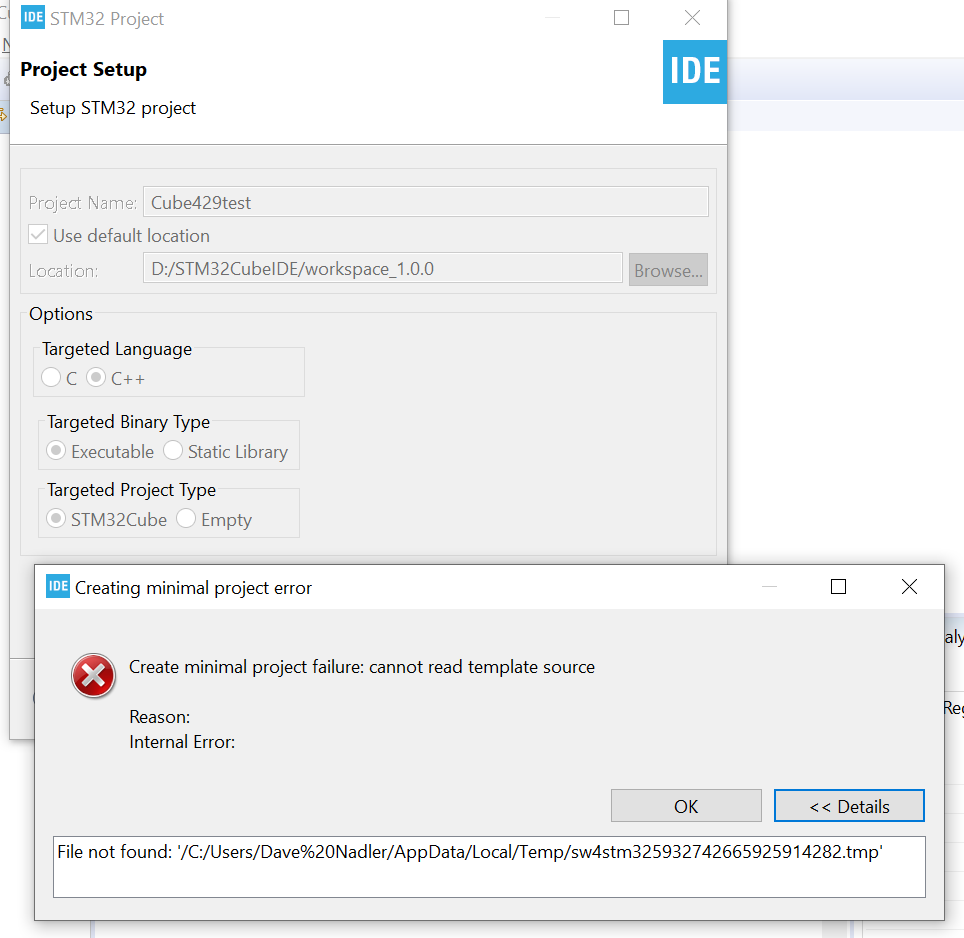

Just downloaded and installed STMcubeIDE 1.0.0 but it doesn't seem to work at all.
Tried to create a new project:
  • selected board Nucleo-F429ZI
  • tried to create a project
Fails as follows:
Any idea what's going on here?
Has anybody actually gotten this stuff to work?
Thanks,
Best Regards, Dave

%20 is a space, if I'm not mistaken? Is the user name Dave Nadler?
There's a ticket regarding the installation not working if installed into Program Files but I guess what is happening here is that project creation won't work with a space in the user name either and is generating a different kind of error.

In order to know for sure if it's the space or not, please test the following:
  1. Exit STM32CubeIDE
  2. Go into the installation directory (C:/ST/STM32CubeIDE_1.0.0/STM32CubeIDE by default) and edit the stm32cubeide.ini file
  3. Add this line at the end of the .ini file: -Djava.io.tmpdir=C:/ST/tmp
  4. Create the tmp folder in the C:/ST directory
  5. Start CubeIDE and try to create a project
Please let me know the result after that. I tried setting up a test environment with a user with a space in its name but I don't get the error at all so I can't test it.

@Markus GIRDLAND​ - Now I can create a default C++ project, so failing on space within the Windows User Name may be the bug.
However: After making NO peripheral changes or doing anything in CubeMX perspective:
  • the Generate Code option/button thing is missing
  • File Save is grayed out
Where has the "Generate Code" button gone?
