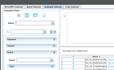

You looking for...this:
What version of : IDE , Cube , cpu     you use ?

From CubeIDE v2.0.0, Project creation & configuration is now handled only in the separate, standalone CubeMX.
The CubeMX functionality is no longer integrated in CubeIDE.
See: STM32CubeIDE 2.0.0 workflow tutorial
For the rationale behind it, and discussion of that, see: IDE Version 2.0.0 - why remove MX ?
