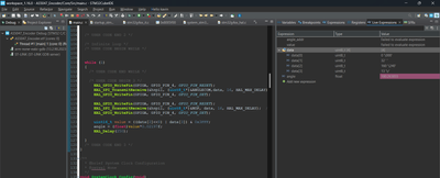

2024-09-01 08:32 AM - edited 2024-09-01 09:34 AM
sorry i couldn't understand your second statement ERbits you mean the don't care bit rights yeah i changed it afterwards to remove the first two bits
You mean like this
while (1)
/* USER CODE END WHILE */
/* USER CODE BEGIN 3 */
HAL_GPIO_WritePin(GPIOA, GPIO_PIN_4, GPIO_PIN_RESET);
HAL_SPI_Transmit(&hspi1, (uint8_t*)&ANGLECOM, 16, HAL_MAX_DELAY);
HAL_GPIO_WritePin(GPIOA, GPIO_PIN_4, GPIO_PIN_SET);
HAL_SPI_TransmitReceive(&hspi1, (uint8_t*)&NOP, data, 16, HAL_MAX_DELAY);
uint16_t value = ((data[0]<<8) | data[1]) & 0x3FFF;
angle = (float)value*0.02197f;
HAL_Delay(250);

2024-09-01 09:14 AM
is my code in the above reply is correct?
2024-09-01 09:34 AM
I tried this and i get a value in the range of 0 to 360 degree but the live expressions doesn't seem to be updating
