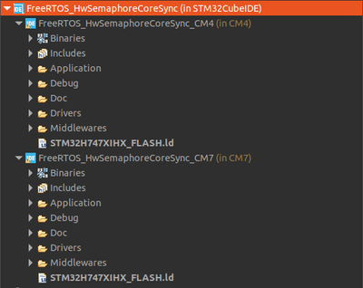

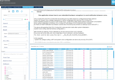

Hi
For example I am choosing another example
I can build both the projects generated here
But i am not able to program them into the board
mƎALLEm
You didn't answer my question. Which part of project is not uploaded? CM4? CM7 or both?
You have two projects inside the example.
I cannot upload both
