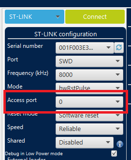

You need to ensure the connection step with CubeProgrammer.
You need to ensure the connection to each of the Cores CM4 and CM7:
To connect to CM7, you need to set the access port to 0:

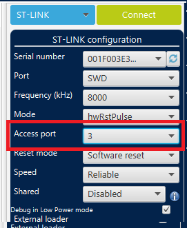

To connect to CM4, you need to set the access port to 3:

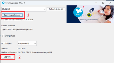

If you succeed to connect with CubeProgrammer, try to update the ST-LINK firmware with CubeProgrammer:
Then,
