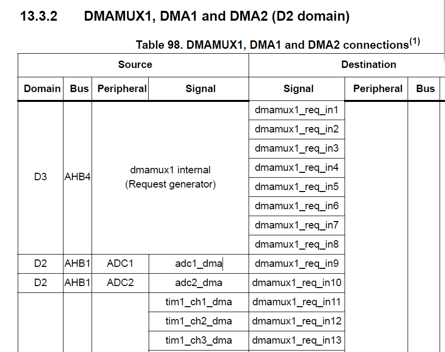

Hello @Bogdan​ ,
You may refer to the RM0468 under subsection Block interconnect, you can find the DMA streams related to ADCs used.0693W00000aJ8XPQA0.png
You can try debugging the code to see if the ADC conversion is completing. Then check the ADC and DMA configurations. You may start with a simple example of single ADC. You can get inspired with this example based on Nucleo H743.

thanks for sharing this info.
So by judging from your picture, in my case for ADC1, this would be DMA1 Stream 9 ?
