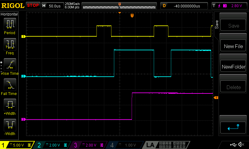

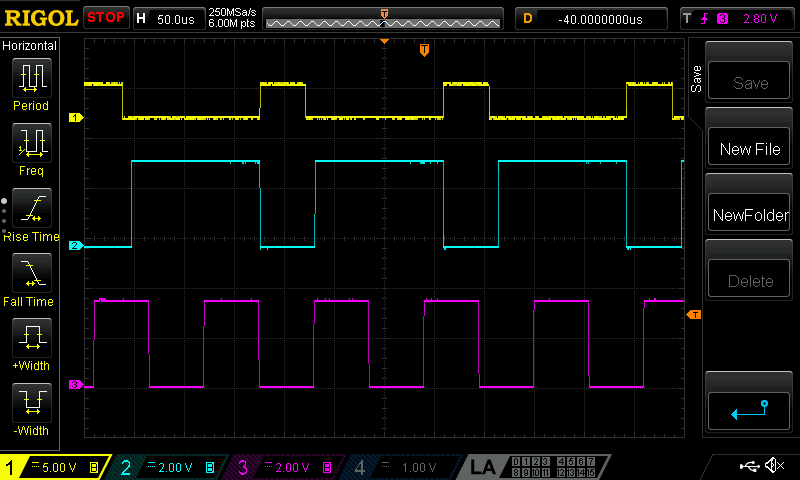

I have set up a GPIO to toggle every time a conversion is made. TIM2 CH1 is yellow, TIM2 CH2 is blue and the adc complete GPIO toggle is purple. As you can see here, on the first ever rising edge of PWM CH2 the GPIO toggles due to the ADC completing its conversion. This perfect and I want this to repeat every rising edge. However, in the second image it doesn't toggle after the exact same time ever again. It is just constantly running the ADC and toggling without respect to the timer.
Perfect on the first trigger:
0693W000001svEMQAY.pngThen continues without timer trigger
I'm convinced that I'm 90% there and all i need to do is clear a bit in a register somewhere ready for the next timer trigger but the reference manual is not clear AT ALL so I've resulted to trial and error. Any help or ideas would be great. There doesn't seem to be any control over this function in the ADC_SR or ADC_CR1/CR2 registers. thanks.
