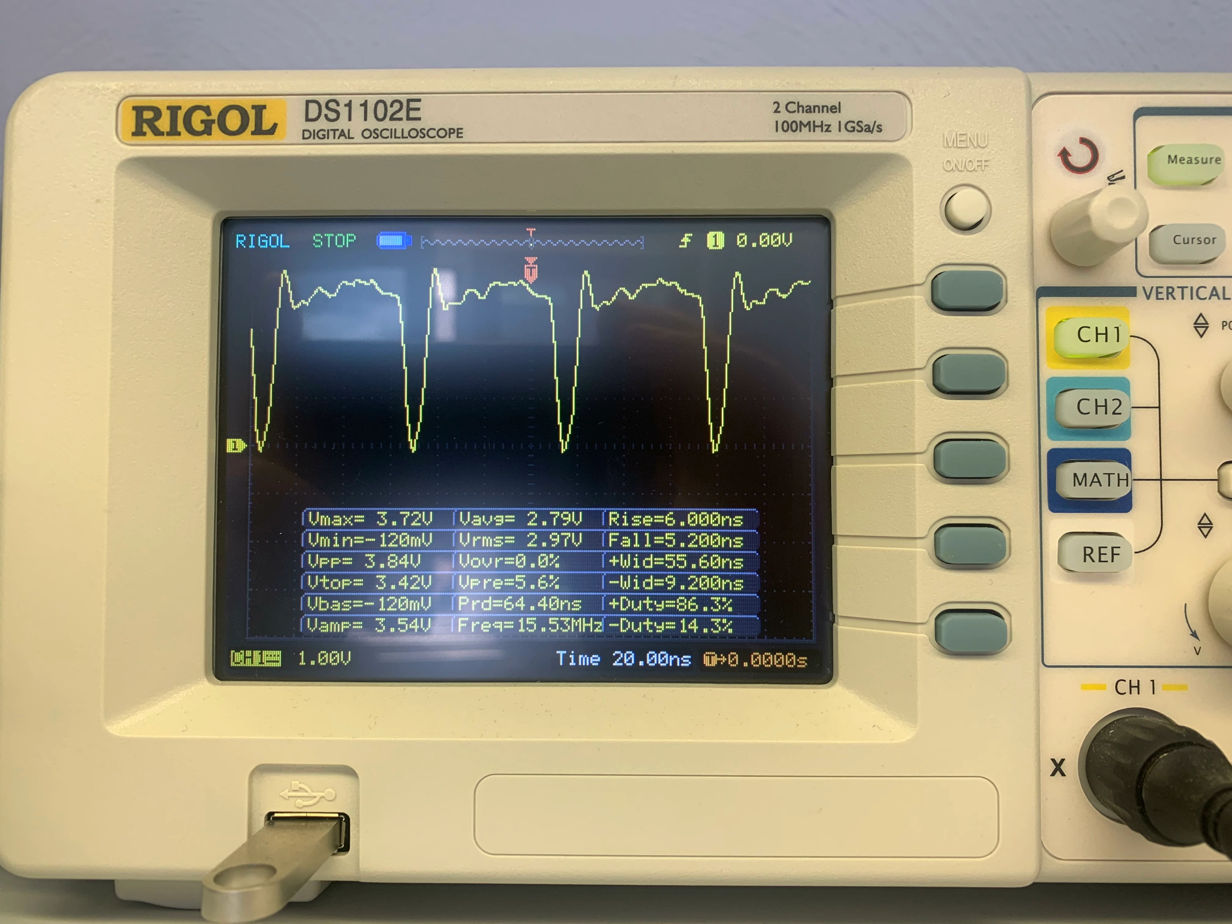

If I put a breakpoint in the loop so that the program pauses before every qspi_read_id() call. Before read_id is called the very first time, the only flag in QuadSPI->SR status register is Fifo Threshold Flag. If I continue the program, 1 second later I'm paused right before calling read_id again, and I already have flags "busy", "transfer complete" and the same "fifo threshold".
The D0 line is definitely firmly stuck at 0v, the scope never triggers. Chip select goes crazy after the first time read_id is called and never stops even while MCU is paused on a breakpoint:
I have obviously misconfigured something, but I'm out of ideas. I read some materials on the topic, will keep researching too, but I was hoping maybe someone could point me in the right direction.

interestingly enough, I tried the preinitconfig example, and it didn't work. Compiled it ok, but no communication. Communication only on TouchGFX project visible. As for _discovery_qspi.c, it's a part of TouchGFX project too, I studied it from top to bottom even before opening this question, it was there where I took params for initialization.
Anyway, for now everything has failed (except TouchGFX-generated project), so I will be comparing it to my project again, maybe put TouchGFX-generated code into my project and see when it starts working. And then putting my code back piece by piece to see where it breaks.
