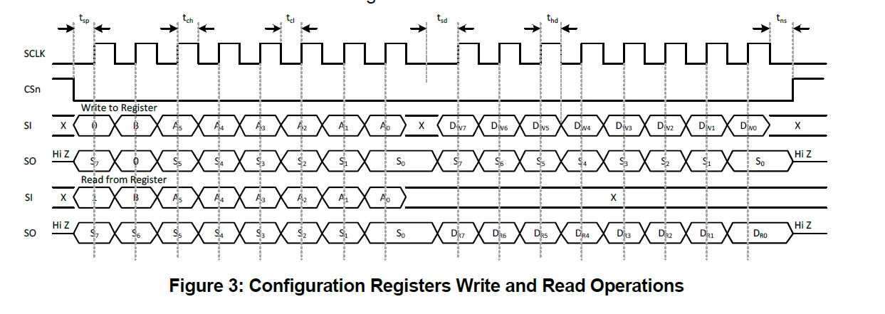

Im currently working on a custom PCB with cc1120 as transceiver and stm32f446RET6 as MCU. I integrate the cc1120 library from IT's library. The device uses SPI as serial communication. Here is the communication example in given datasheet.

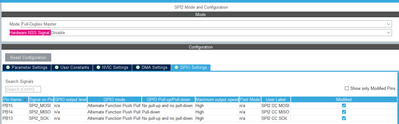

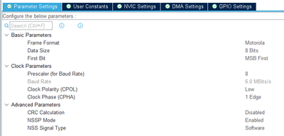

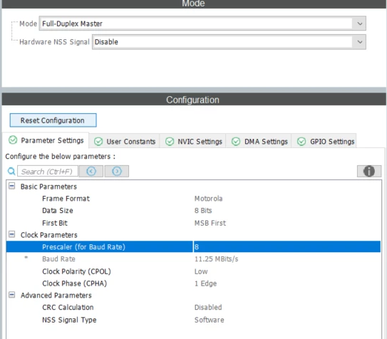

 With this information i configured the SPI settings as:
after that i use HAL_SPI_TransmitRecieve( ) function as my comm func. in driver. But im not gonna share the complex library instead i will demonstrate the situation. My CS pin and cc1120 reset pin is logic HIGH in idle by software.

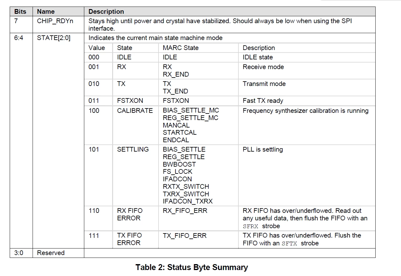

In this code first i use command SRES (0x30) for reset the device. In this situation device must be send chip status from MISO line when i start to transmit from MOSI line. But i cant see the chip status byte in MOSI line (Im seeing 0xFF as chip status byte). Chip status byte explained in datasheet as: "When the header byte, data byte, or command strobe is sent on the SPI interface, the chip status byte is sent by the CC112X on the SO pin." and:

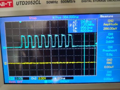

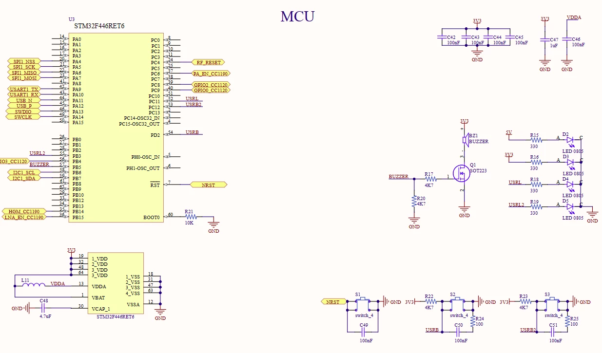

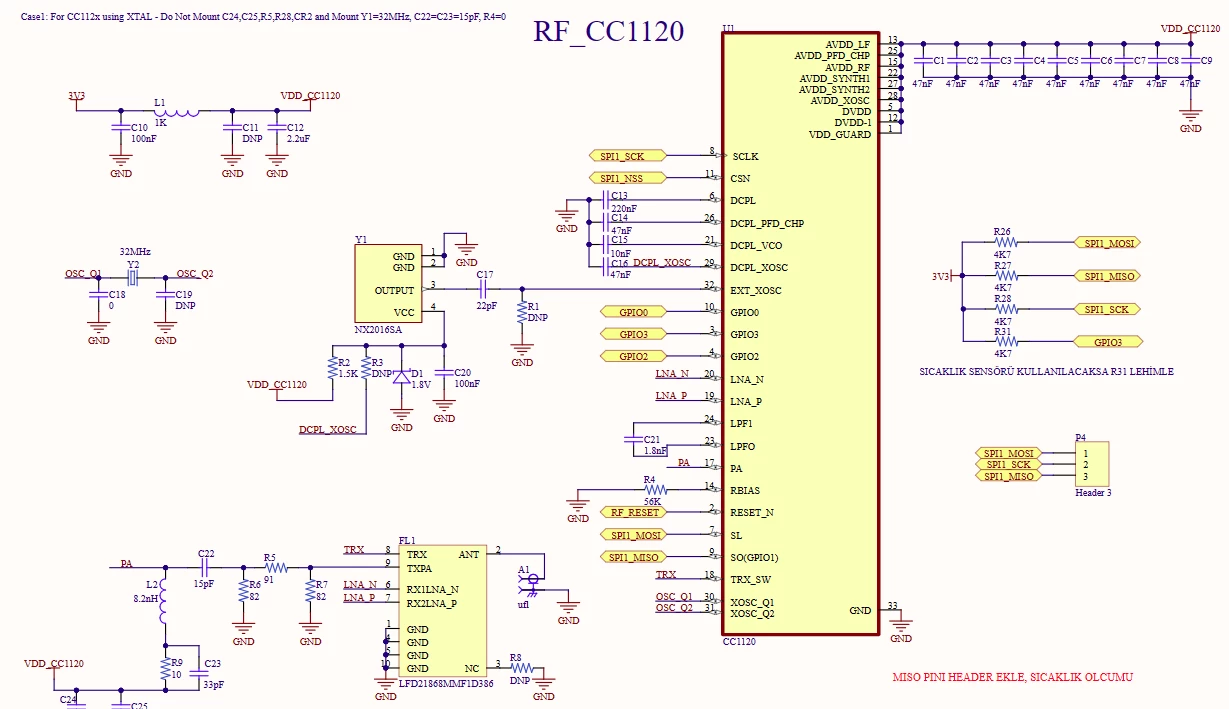

So i cant reach the cc1120 device but i don't know why. I tried several different configurations. I use oscilloscope for see the lines and SCK line looks fine to me. Here is the MCU and the RF part of pcb. Almost same as the reference design of the cc1120:

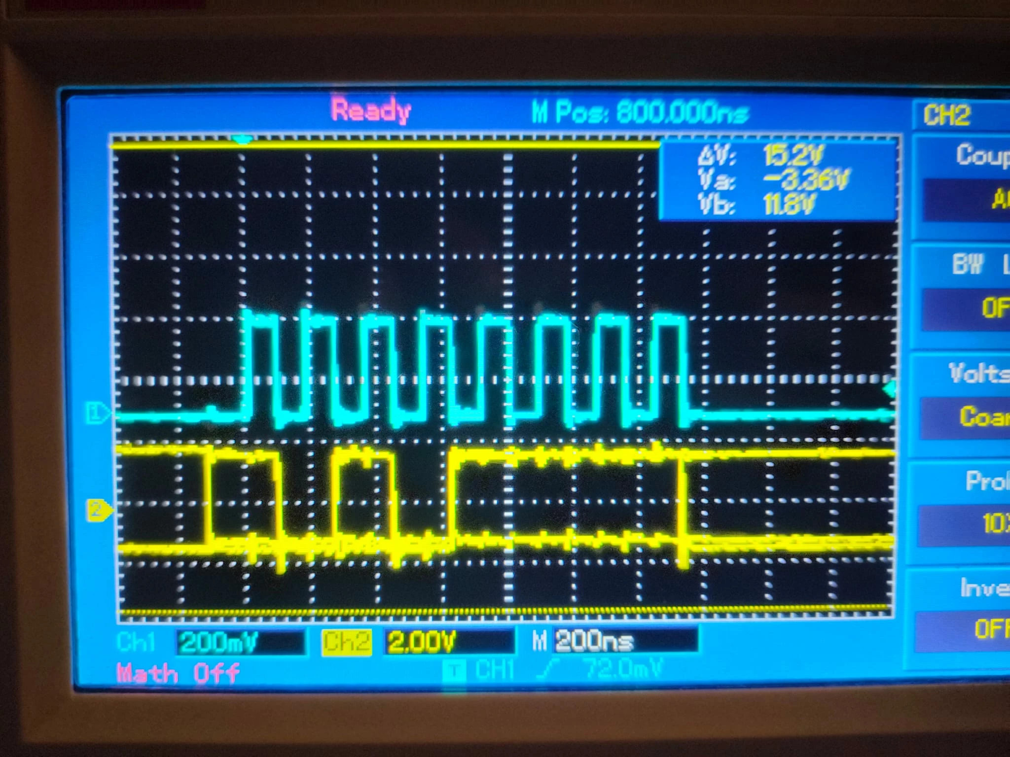

So there is a external 32MHz oscillator indicated as Y2 but we don't have it so we use 32.578 MHz instead. Is that a problem for the device? Here is the scope results:
Ch1:SCK
CH2:MOSI
In MISO line im only seeing logic HIGH voltage and nothing else. I think that MOSI line scope results overlapping in while loop but im not sure. How can i solve this problem?

We solved the problem. We were using a 32.768 MHz instead of 32 MHz oscillator. When we soldered 32 MHz, one SO line pulled logic LOW when CS was asserted.

Are you sure that you have the SPI Mode correct?

@mrkayaalp wrote:
So there is a external 32MHz oscillator indicated as Y2 but we don't have it so we use 32.578 MHz instead. Is that a problem for the device? ?
You really need to ask TI that question!
It looks like the only GND connection to the CC1120 is the pad on the underside - are you sure that is soldered correctly?
You need to set your scope to single-sweep - so that you don't get multiple SPI transactions overwriting each other.
Maybe also put a breakpoint in your STM32 code, so that it only does a single read.
Does your scope not have a proper screen capture facility?

Thank you for your response. I swiftly raised the issue on the TI forum and am awaiting their guidance. Confidently, I've configured the SPI settings for Full Duplex Communication, and upon reviewing, the clock configurations appear to be in order.

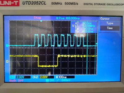

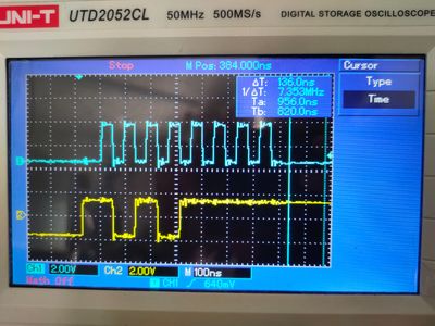

So i manage to get better scope results: 
In while loop firstly im sending (0xAF -> 0x2F | 0x80) with 1 in the MSB for read operation  (Sending 0x2F first for extended adressses). MOSI and SCK
Then im sending 0x8F for register adress:

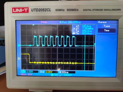

 Then im sending all zeros for recieve the data:
 But again i cannot see anything in MISO line:
Your scope has a USB socket on the front:
Use that to download proper screenshots - far better than photos!

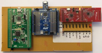

eg,
that's for testing comms between an STM32 Discovery Board and a BOOSTXL-CC1125 (also an AVR).
