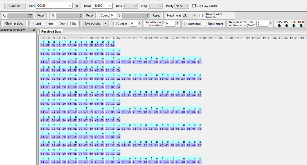

STM32F429ZI UART5 data is received on terminal only for Baud rates 9600 & 4800 for higher baud rates we get garbage data. What can be the issue ?
Rahul1
System Clock is PLL_HSE
HSE connected is 12MHz
HSE_VALUE is set 12000000 & SystemCoreClock = 180000000 in system_stm32f4xx.c
HCLK = 180MHz
PCLK1 = 45MHz
PLLM = 12;
PLLN = 360;
PLLP = RCC_PLLP_DIV2;
PLLQ = 4;
Clocks are configured as expected, cross checked RCC registers through debugger.
Baud rate register is also verified and the value matches with the calculations.

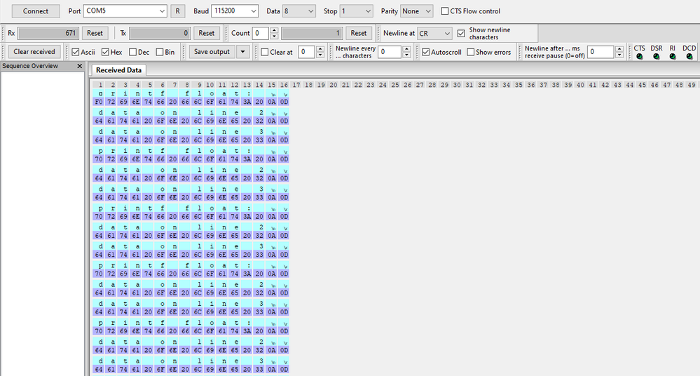

Terminal view is as follows:
Kindly go through it, anything else you need just tell me.
Waiting for your valuable input.
waclawek.jan
Very interesting - almost completely repeatable, and much of the characters gets through unaffected, that's remarkable.
I'd say, there's some slight baudrate mismatch involved. I know you are using HSE/crystal and the baudrate is not that high compared to system clock, so the mismatch should be relatively low; but what's on the receiving side? Is it some USB-to-UART converter? Can't that be mismatched? Can you try a different one (different make, different chip)? Or, even better, can you locate a PC with an onboard UART? Can you try to transmit on it and measure precisely enough the bit duration (you need to get to some 1% resolution at least)? Is there some level conversion involved (RS232)?

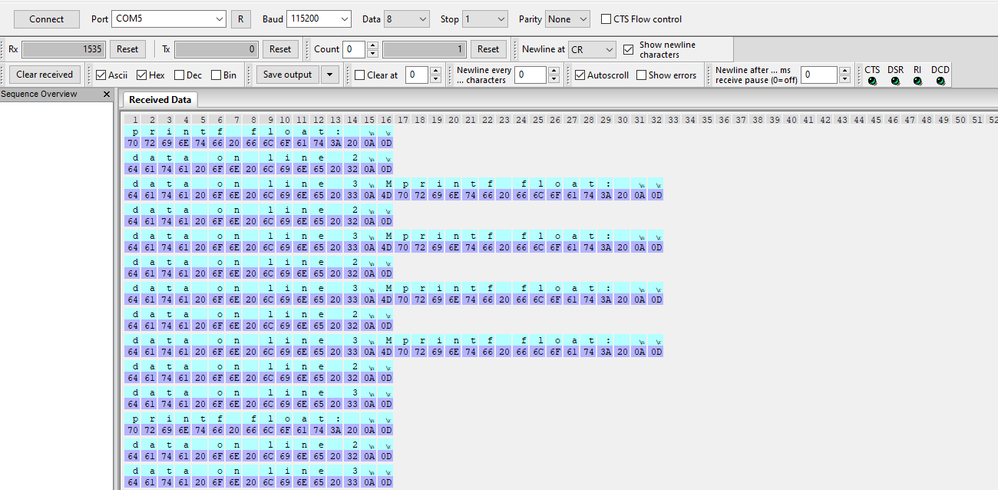

Rahul1
You are right USB to RS232 converter was the issue.
Changed it with FTDI FT232RL.
Now issue is little different as you can see below
and also like below:
Please check
