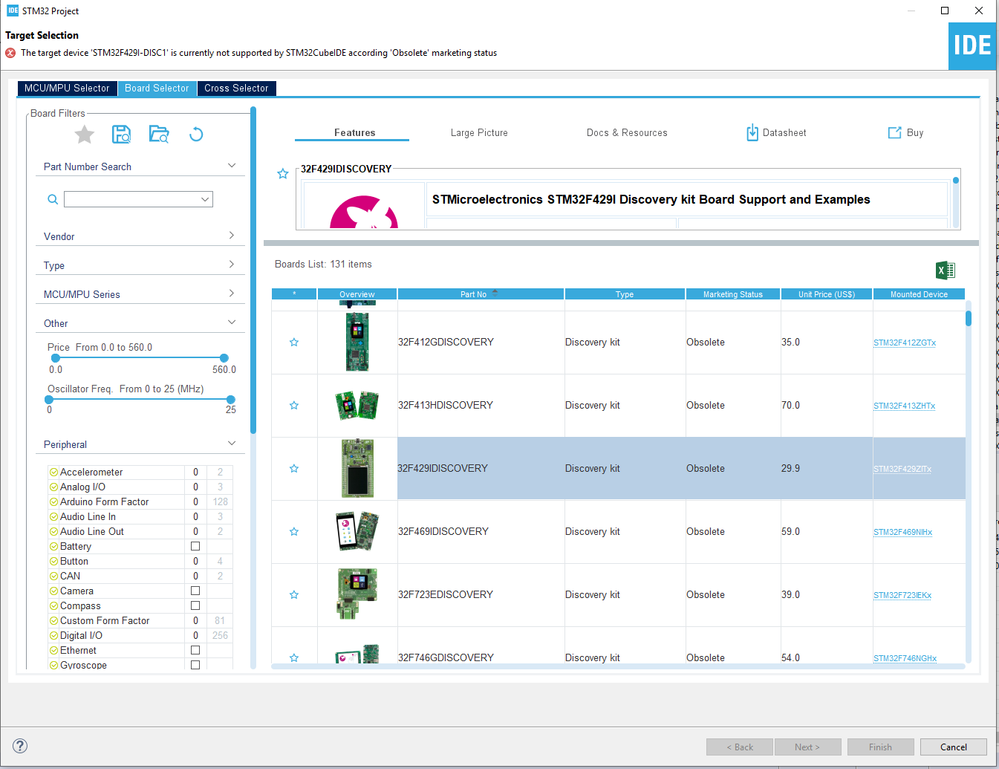

I just wanted to create a new project for the board ( last project I created about 24 hours ago, was still working ). That caused an update to run, the device is now obsolete, and I can't create projects, get the error: The target device 'STM32F429I-DISC1' is currently not supported by STM32CubeIDE according 'Obsolete' marketing status
As of now, the status on https://www.st.com/en/evaluation-tools/32f429idiscovery.html is still ACTIVE. What is that, and how can it be fixed urgently?

Update....ALL development boards are marked as Obsolete!

IBret
IBretAuthor
September 21, 2019
All development boards became obsolete....very much looks like a bug.0690X00000ARTWHQA5.png

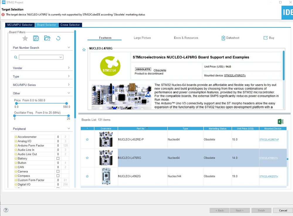

0690X00000ARTZuQAP.jpgSame experience here. I attended an ST workshop 2 days ago and got this board. This board cannot be obsolete, in reality. Has to be a bug.
I tried uninstall and re-install of STM32CubeIDE - got same result.
I pulled out my laptop from the workshop, and disabled the wi-fi before running STM32CubeIDE. Similarly to in the workshop (where there was a very slow wi-fi) - at the time of "Initializing target selector" it asked if I wanted to set up an internet connection. I said no. In this laptop instance, the NUCLEO-L476RG board is in active mass production.
The apparent conclusion is that the target selector performs a transparent update if STM32CubeIDE has an established connection when it's executed.
I'll confirm this in a few - have to drop internet to try it.

TKeel
September 21, 2019
Ok - I uninstalled and reinstalled STM32CubeIDE with no internet connection, no change in result.
I had to manually go into c:\Users\(me)\ and blow away all 3 directories .stm* and both STM32Cube* directories. These were not erased by the uninstall.
With internet still off, I then restarted STM32CubeIDE and created a new project. The answer box then popped up during "Initializing Target Selector" I selected "no" and "remember my decision". Coming to a further point where more software had to be downloaded (if I were smarter, I may have avoided this by just blowing away only the .stmcufinder directory - but I then opted to turn internet on and "set this connection now". I chose a radio button which selected "no data update at startup" - checked connection (ok) then downloaded the file.
I now have my new project with my target board.
I closed out of STM32CubeIDE and tried to restart. This time, during "Initialize Target Selector" - it downloaded files.....and my board is now again "obsolete" - even though I asked it to "remember my decision" and "no data upgrade during startup" .
More later after I try a bit more refined and less "bullish" approach. But I have to shut down internet again.
TKeel
September 21, 2019
Ok - my suspicion was confirmed. I shut down internet, blew away only the .stmcufinder directory ( C:\Users\(me)\.stmcufinder\ ) and STM32CubeIDE "remembered my decision" - I again have my new project on my board.
