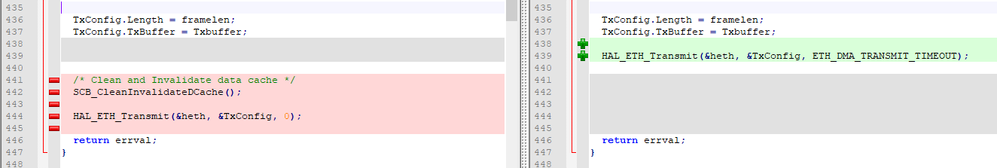

Hello!
I ported my projects from Atollic TrueSTUDIO® for STM32 (Version 9.3.0) and STM32CubeMX (Version 4.27.0) to STM32CubeIDE (Version: 1.0.2).
When testing my Application, Ethernet did not work until i changed the ethernetif.c file generated by STM32CubeIDE (Version: 1.0.2).
In Detail, i added a line in this function:
static err_t low_level_output(struct netif *netif, struct pbuf *p)
Concretely, i added:
  SCB_CleanInvalidateDCache();
before the transmit function is executed:
  HAL_ETH_Transmit(&heth, &TxConfig, ETH_DMA_TRANSMIT_TIMEOUT);
This was done in my old project, which was generated by STM32CubeMX (Version 4.27.0).
The attached picture shows the differences in STM32CubeMX (Version 4.27.0) [LEFT] and STM32CubeIDE (Version: 1.0.2) [RIGHT].
Why do I have to add this line?

Invalidating all cache will damage other unrelated data. Cleaning all cache can be safe, but is much slower anyway. Proper way is this:
for(q = p; q != NULL; q = q->next)
	SCB_CleanDCache_by_Addr(q->payload, q->len);
This must be added to the for loop inside low_level_output().
ser_u
Thanks for the advice. I changed it like you said and it works, too.
But why do I have to add this line? And why is it not added automaticly by STM32CubeIDE (Version: 1.0.2)  ?
My MPU settings and linker command file are copied from "LwIP_HTTP_Server_Netconn_RTOS" example in "STM32Cube_FW_H7_V1.5.0".
The MPU settings look as follows:
