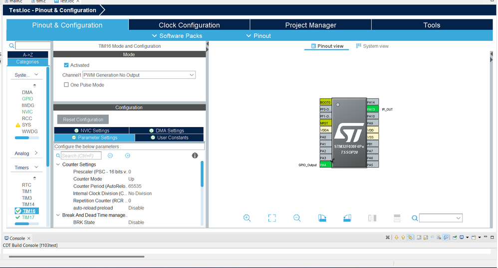

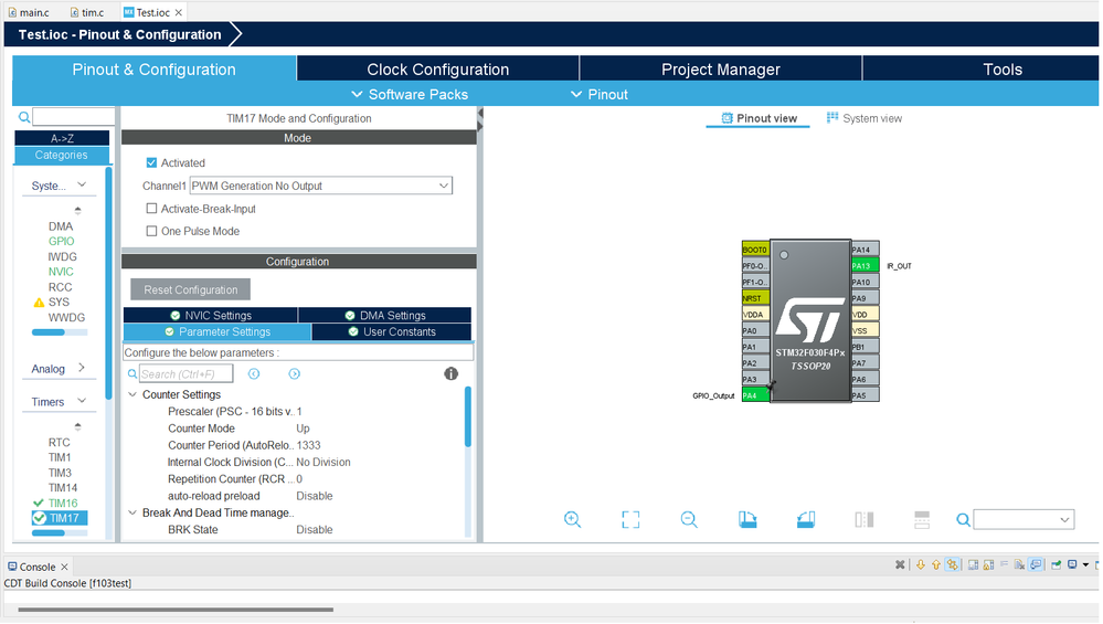

PAndr.3
Have I set the timers correctly?
Where can I find the ir library?
