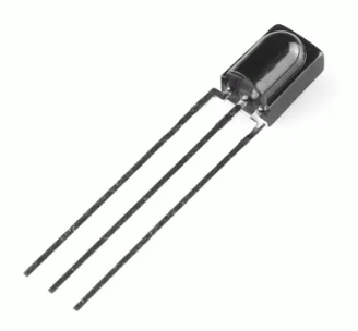

Which IR receiver you have ?

I have some old obsolete IR receivers for testing, but will probably go with TSOP96336TR in the long run.

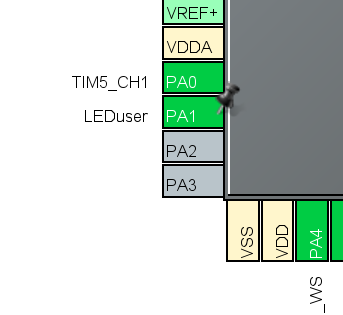

What you need is just an (old) receiver, connected to a TIM input; i used TIM5 ch1 (as free on my board):
Needs no lib, receiving is done in the timer INT - thats all. (Needs about 4us , at 200M core speed.)
Result is : nothing -- or a valid command sequence.
