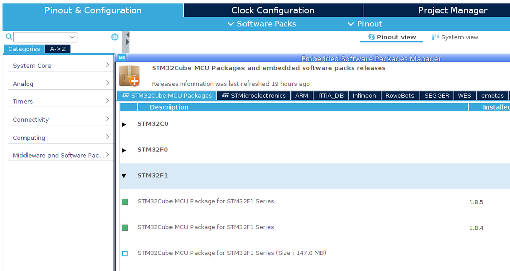

I had no dedicated version of CubeMX installed. Why would I need it as an extra program?
I installed version 6.11.1 now, but it did not change anything in the IDE, I still don't see the box to untick to choose a different FW package (same look as in the screenshot).
‎2024-05-02 12:02 AM - edited ‎2024-05-02 12:05 AM
Go in Cube to -> software packs -> manage.. and select/install...if there a more recent version.
On open Cube/ioc , -> migrate , to use new version.

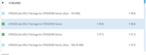

I have installed FW version 1.17.3 and 1.18. The project currently uses version 1.17.3
But I have no clue how to change that to the newer version 1.18. When I open the .ioc file I don't get the popup asking to migrate the project. And the project manager does not offer the possibilty to change it either (see screenshot in first post).

‎2024-05-07 11:25 PM
I now updated to to WB FW 1.19.0, restarted IDE and it is still the same behaviour.
- No migration dialog when opening the .ioc
- No option in the Project Manager to change the FW version used.
