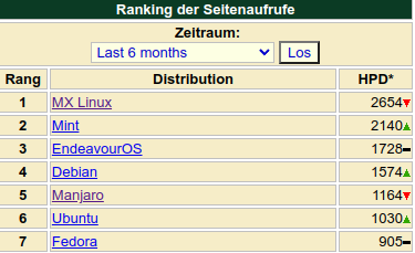

Hello  @Rim LANDOLSI ,
its not ubuntu...its MX.   see ranking...and ubuntu..
https://distrowatch.com/table.php?distribution=mx
