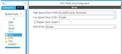

1. set hse clock to bypass ;

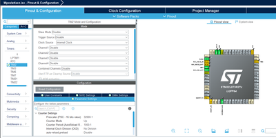

2. set auto reload preload: enable

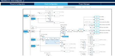

Check the MCU is actually running at 32 MHz, print out the SYSCLK, AHB, APB1, APB2 clocks via a printf()
Output the MCU clock via MCO PA8 pin, and measure that.

1. Why set clock into bypass and not into crystal resonator ? Many tutorials says to use crystal resonator and I don't know why bypass, because in both I have 32MHz or it changes something ? I am a bit confused. Because in tutorials it says to use crystal resonator. When I set the timer to 1 sec or 5 sec it worked for crystal resonator but in this program 3 s didn't work I don't know why.
2. Why do I need auto reload preload enabled ? Why in this example because usually in tutorials it says not to use it as well.

1. on your board the clk comes from st-link, not a crystal. so set to this. the input might (i dont know) be different, in switching level etc. , when set to crystal.
2. if you want a constant frequency and write it once to arr, you want it reload every cycle with this value. What its doing without this - i am not sure, i have to read the manual..as you. :)
thats why i wrote: is not good. its like : you start driving your car in 3rd gear, but you should use  1st gear - so maybe, it works, or has new side effect. :)
3. dont know - seems the clock was wrong; if you want know for sure, do like @Tesla DeLorean  wrote: check real clk by using mco and a scope; and try what happens with arr preload ena or disabled .

> "1. on your board the clk comes from st-link, not a crystal. so set to this. the input might (i dont know) be different, in switching level etc. , when set to crystal."
What ? CLK comes from st-link ? So the BYPASS takes the oscilation from st link and the Crystal from the extern oscilator which is resonator ?
But okey, I read that the resonator is
  • 32.768 kHz crystal oscillator
So I thought that it would work. And it worked for some cases and for other it didn't I don't understand why. Is there any reason ? The settings seems okey, for some application when I use crystal it works normally I set for 1 s and it works for 1 sec. But here it didn't.
"2. if you want a constant frequency and write it once to arr, you want it reload every cycle with this value. What its doing without this - i am not sure, i have to read the manual..as you. :)
thats why i wrote: is not good. its like : you start driving your car in 3rd gear, but you should use  1st gear - so maybe, it works, or has new side effect. :)"
I have used the timer without the preload and it also worked.
I read that preload is needed when I change the counter value in real time. But I use only 1 counter value and I don't change it. So I guess it is not needed ??? Or maybe I am wrong sorry. I don't know what else a value he could load.

If there is any need to show more I can show more. Although the main program and the ISR is fully posted so here is the timer :
static void MX_TIM2_Init(void)
  /* USER CODE BEGIN TIM2_Init 0 */
  /* USER CODE END TIM2_Init 0 */
  TIM_ClockConfigTypeDef sClockSourceConfig = {0};
  TIM_MasterConfigTypeDef sMasterConfig = {0};
  /* USER CODE BEGIN TIM2_Init 1 */
  /* USER CODE END TIM2_Init 1 */
  htim2.Instance = TIM2;
  htim2.Init.Prescaler = 32000-1;
  htim2.Init.CounterMode = TIM_COUNTERMODE_UP;
  htim2.Init.Period = 3000;
  htim2.Init.ClockDivision = TIM_CLOCKDIVISION_DIV1;
  htim2.Init.AutoReloadPreload = TIM_AUTORELOAD_PRELOAD_DISABLE;
  if (HAL_TIM_Base_Init(&htim2) != HAL_OK)
    Error_Handler();
  sClockSourceConfig.ClockSource = TIM_CLOCKSOURCE_INTERNAL;
  if (HAL_TIM_ConfigClockSource(&htim2, &sClockSourceConfig) != HAL_OK)
    Error_Handler();
  sMasterConfig.MasterOutputTrigger = TIM_TRGO_RESET;
  sMasterConfig.MasterSlaveMode = TIM_MASTERSLAVEMODE_DISABLE;
  if (HAL_TIMEx_MasterConfigSynchronization(&htim2, &sMasterConfig) != HAL_OK)
    Error_Handler();
  /* USER CODE BEGIN TIM2_Init 2 */
  /* USER CODE END TIM2_Init 2 */
The code seems ok, but for some application the timer works ok and for some it doesn't, when I use the crystal and not the bypass I don't get it.

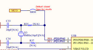

1. there is no hse crystal...see circuit of board. (btw which board you have ? i looked at -C04 )
+ 32kHz is lse crystal, should be there.

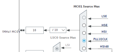

3. set mco output "on" . then in clock tree choose, what there should be : master clk or whatever you like to see and is possible (on this chip).
this you "see" on a scope then, on mco pin. thats all.
i do this on a new board always - just to be sure, it works as i want. then disable and use pin for something else ...or let it run , as you like.
