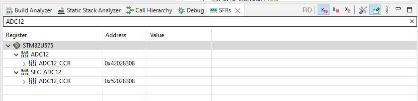

I am quite new in STM32 programming. Today I was fighting with the ADC1 module and during debugging found out that the SFRs window didn't have the ADC12_COMMON registers section! Is it really so, or I simply cannot find it there? I program the NUCLEO-U575ZI-Q board.

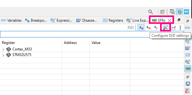

Thank you Kaouthar! Could you please let me know, where exactly to drop this file?
KDJEM.1
Hello @Skfir​,
1.Extract the file.
2.Open STM32CubeIDE.
3.Click Window -> Show View -> SFRs.
4.Click Configure SVD settings as shown in the below figure.

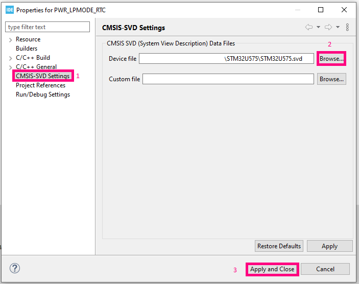

0693W00000WJWFYQA5.png5. Browse the .SVD file shared with you.
0693W00000WJWGCQA5.png6.After that you can see the ADC12_CCR in the SFRs window as shown in the below figure. 0693W00000WJWLRQA5.pngThank you for your contribution in the ST community.
