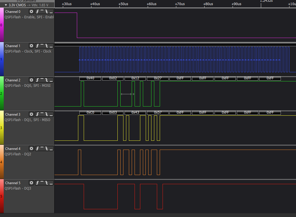

Curiously enough, the waveform contains the entire first word, the entire second word that I never asked, then it also contains a few dozen more clock cycles and it never releases chip select. It stays low forever.
This is the waveform that addressing memory in memory-mapped mode does:
0693W00000WJWonQAH.pngSo there is an instruction, there is address (0x000000), dummy bytes (6 now, but since it's 1MHz, it should - and clearly does - work, because otherwise I wouldn't get my first byte). Then comes the data - 8 bytes of it. And then clock runs for some time and chip select never releases. And the variable has only 1 byte, the other 7 bytes were discarded. So physically I receive 8 bytes plus never ending chip select, while variable has only 1 byte. Whereas the correct behavior would be to read only 4 bytes and release chip select there. I set data length register to 3 (4 bytes). Also, I tried timeout value 0xFFFF and 0x0000, it makes no difference at all, I believe it's not relevant to specifically this situation.

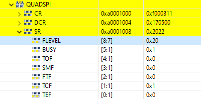

These are QUADSPI registers AFTER this memory mapped read:
This is how I enable memory mapped mode:

I would be grateful if someone pointed me in the right direction. I don't understand what I misconfigured, why my QUADSPI has 20 bytes in fifo after requesting 1 WORD, and why even tho I have my entire 32-bit word waveform, I get only the first byte of data into the actual variable.
