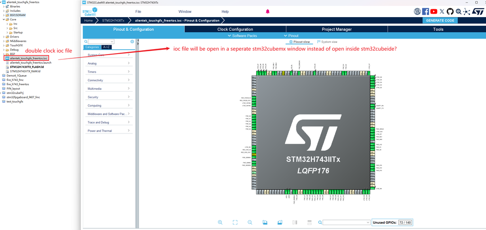

I do not know what happened. If I double-click ioc file, it used to open inside CubeIDE. But now it will open inside another separated cubemx window. I may have changed some settings by mistake.
How to change the settings back so I can open ioc file inside CubeIDE?
Best answer by Issamos
On the STM32CubIDE V2.0.0, the STM32CubeMX plug-in has been removed. So, the .ioc file is opened out of the STM32CubeIDE on the standalone version of the STM32CubeMX.
Best Regards.

Did you update to CubeIDE 2.0?
snkparty1Author
November 19, 2025
Yes, now I knew the  reason.
Best Regards.

Is there any chance this functionality will be added agian in the future?
I found it pretty useful.
Can users "re-add" it via plug ins manually? Or are there some issues with newer versions now?
Lead III
April 10, 2026
ST gave clear motivation:
https://community.st.com/t5/stm32cubeide-mcus/stm32cubeide-2-0-release-early-heads-up/td-p/810967
integration leads to heavy/poor performance, stability issues across OSes and monolithic updates
Updateability: Offering the possibility to use any version of STM32CubeIDE with any version of STM32CubeMX. Separating STM32CubeMX and STM32CubeIDE allows developers to update each tool independently, lowering risks and increasing flexibility.
For me having 2 dedicated tools has an advantage. I have 2 screens or an ultrawide screen and I used MX and IDE side by side. It also helps separating the workflow of configuring hardware and writing application code.
