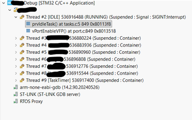

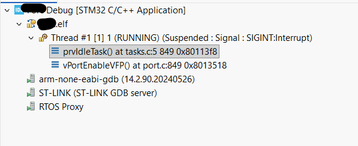

DreamOnDirac
Hi
The symptoms were that the tasks were listed so that the call stack could be investigated
This is what i expect
This is what i got
