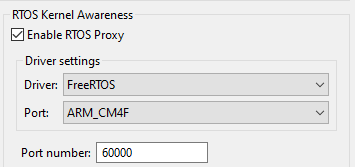

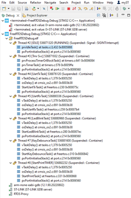

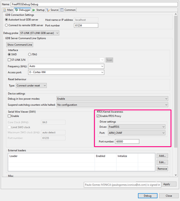

RTOS-kernel-aware debug
The RTOS-kernel-aware debug feature in STM32CubeIDE facilitates support for Microsoft Azure RTOS ThreadX and FreeRTOS™ operating systems, through the use of an RTOS proxy. The STM32CubeIDE includes the RTOS proxy, which can be utilized with an STLINK GDB server, OpenOCD, and Segger J-Link GDB server.
To enable RTOS-kernel-aware debugging, the "debugger" tab in the "Debug Configurations" dialog contains settings to enable and configure the following:
  • RTOS proxy
  • Driver (RTOS ThreadX or FreeRTOS)
  • Port (Cortex® core) and configuration of port number to use with the proxy.
Upon enabling RTOS-kernel-aware debugging and initiating a debug session, all threads are displayed in the debug view. By selecting a thread in the debug view, the current context of the thread is visualized in various views. For example, the variables, registers, and editor views reflect the active stack frame. For example:

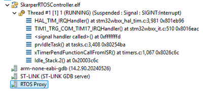

Jun 26, 2025 4:06 PM UTC
This is great. Everything works except the thread view, which only shows one thread. Any tips about how to debug it?
I am using FreeRTOS on a WB55. I have RTOS Proxy enabled and 15 threads running.
